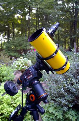

MesajTrimis: 08 Sep 2011 22:52 Download mesaj
'' Iar se intampla''.
Iata telescopul lui Mark Christensen cu apertura de 152mm F/2.74 ,respectiv F/3.1 deoarece ParaCorr 2 are un usor efect de alungire a focalului ,telescop prezentat pe atm free.
Comentariul lui Mark pentru aceasta poza:
''6 inch f/2.74 parabolic mirror, normally used with ParaCorr Type 2 coma corrector to produce f/3.1 system. AL tubing and Zinc Chromate primer from 1960s. Mirror was originally ground and polished around 1972 but as finally figured in the Spring of 2011. These things sometimes take a while''
