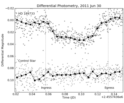

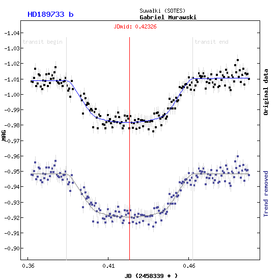

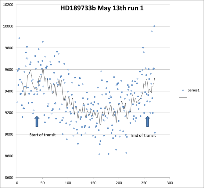

MesajTrimis: 14 Oct 2018 13:26 Download mesaj
Da, se poate, chiar si fara ditamai dobsonul.
Tehnica se numeste "differential photometry".
https://www.cloudynights.com/topic/462161-...hote-lens/
https://spectrum.ieee.org/geek-life/hands-...t-detector
http://www.scientificterrapin.umd.edu/Fall...lanets.php
http://var2.astro.cz/EN/tresca/transit-detail.php?id=1533923337
Pe la vecini e deja sport national (sa nu zic ieuropean):
http://var2.astro.cz/EN/tresca/transits.php
Apropo, prima exoplaneta a fost descoperita pe radio, unde nu se astepta nimeni ... in jurul unui pulsar ...
 Marime fisier:  86.63 kb
 Vizualizat:  de 12219 ori
 Marime fisier:  32.47 kb
 Marime fisier:  13.18 kb
