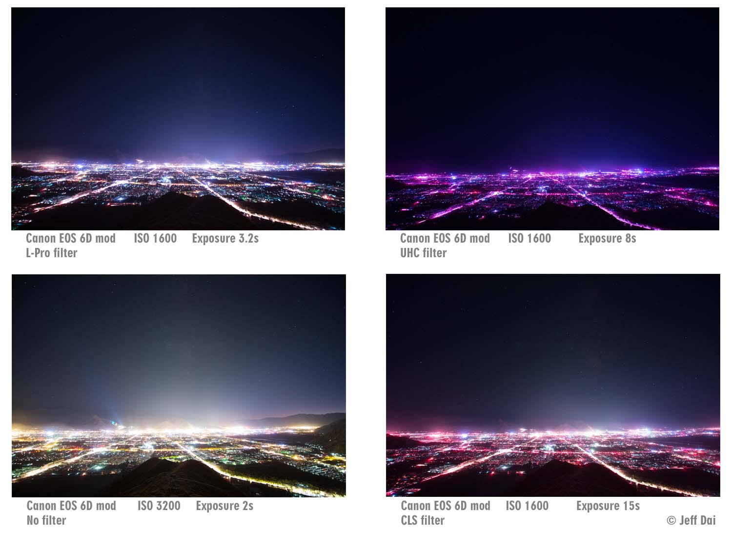

La Optolong am gasit urmatoarea specificatie:
The Optolong CLS (City Light Suppression) broadband filter is designed to improve the visibility of various deepsky objects. By selectively reducing the transmission of wavelengths of light pollutants, specifically those produced by artificial lightings including mercury vapor lamps, both high & low pressure sodium vapor lights and the unwanted natural light caused by neutral oxygen emission in our atmosphere (i.e. skyglow). Together with the high transmittance in main emission lines of nebulae, namely O-III(496nm and 500nm), H-beta (486nm), N-II(654nm and 658nm), H-alpha(656nm) and S-II(672nm), the filter is suitable for enhancing the contrast and details for both visual and photograghic purpose at sub-rural area.
Din imaginea atasata inteleg ca mai ok ar fi UHC-ul ...

Diferenta pozitiva ar fi ca CLS vede muntii din fundal pe cand UHC nu prea, ceea ce inseamna ca ia mai multa lumina in favoarea contrastului

zoth a scris:
Cu mentiunea ca UHC-ul are un timp de expunere de 8s iar CLS-ul de 15s
Greu de facut o comparatie reala intre UHC si CLS daca expunerile nu sunt identice.

Manu72 a scris:
Corect. Nu am fost atent la timpul de expunere ...
Ar fi interesanta o comparatie in modul vizual intre cele doua filtre.

Dintre cele patru poze puse de zoth ,cele din dreapta imi ''suna'' cunoscute , cam asa diferenta vad eu intre UHC si Skyglow.
UHC este insa un filtru foarte puternic pentru apertura de 125mm , voi relua comparatiile cu apertura mai mare.
