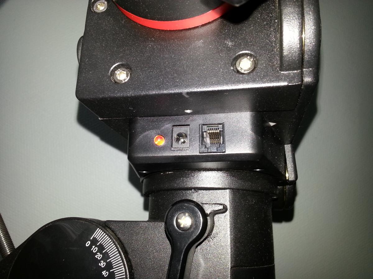

Am un HEQ 5 Syntrek Heavy-Duty are un hand controller foarte simplu doar pt RA si Dec. Are cineva o schema pt a conecta aceasta montura la calculator ?...Mentionez ca singura mufa este un RJ 11 cu 6 pini si cea de alimentare Smile.
Multumesc mult

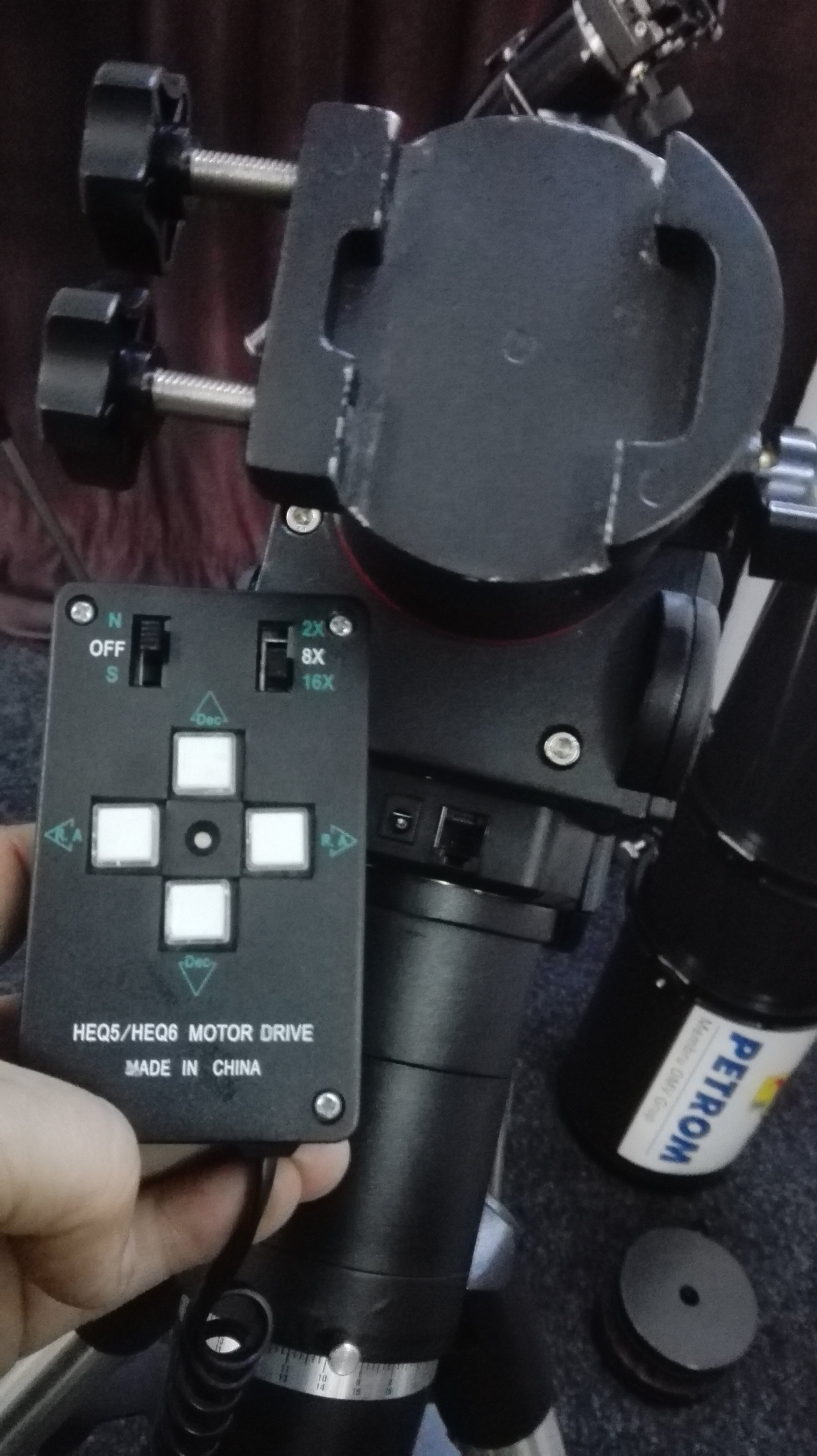

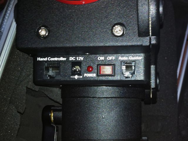

Stai un pic. Esti sigur ca-i HEQ5 Syntrek ?
Dupa poza arata a fi HEQ5 Classic.
In cazul asta s-ar putea ca acel port cu 6 pini sa functioneze ca si autoguider.
Ce vrei sa faci legand montura la calculator ?

Da vreau sa l leg la calculator . Daca poate sa cineva stie pinout ul la RJ 11? Si ai dreptate cred ca e HEQ 5 Clasic cu controller ul din imagine. Daca vrei iti trimit mai multe poze.
Daca ai vreo idee ar fi grozav ...Multumesc mult Smile

Cea mai simpla metoda ar fi sa cumperi kit-ul original de upgrade la GOTO.
Mai poti face un modul de genul: http://projects.gbdt.com.au/eq6-1/
Din pacate, portul existent nu este de autoguider.
Este un port serial mai ciudat.
Din codurile sursa:
Cod:
/* This file describes the data in the EQ6/Atlas hand paddle serial stream.
 * This is a one-directional serial stream at 935 bits/sec. This is a fairly
 * wierd speed that seems to be used to give an overall serial stream time
 * of 76.2ms [basically the full-step time for siderial rate, which is
 * half of the actual half-step rate].
 * See the file eq6-serial.txt for further details.
Pinout:
Cod:
Controller connector port:
Pin numbers from RIGHT looking into socket with tab up (as numbered on
controller board)
1:   Switched +12V from hand controller
2:   Ground
3:   Data from hand controller via 1K resistor
4:   Short to pin 1
5:   +12V from source via diode
6:   Short to pin 5
