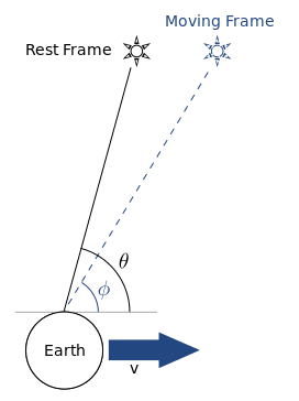

Mai exista o deviere aparenta cauzata de miscarea relativa a Pamantului:
https://en.wikipedia.org/wiki/Aberration_of_light
The apparent position of a star viewed from the Earth depends on the Earth's velocity. The effect is typically much smaller than illustrated.
