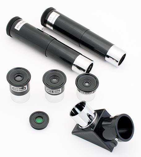

In plus, accesoriile cu care vine sunt numai bune de aruncat la gunoi.
The Starscope 707 includes a large selection of useful Rolling Eyes accessories:
-- 1.25" eyepiece with 20mm focal length for 35x magnification (search, widefield)
-- 1.25" eyepiece with 12.5mm focal length for 56x magnification (intermediate magnification)
-- 1.25" eyepiece with 4mm focal length for 175x magnification (maximum possible magnification)
-- 3x Barlow lens for doubling the magnification Shocked
-- 1.5x erecting lens for a correct image for terrestrial viewing (normally the image is upside down and reversed)
-- 5x24 finder scope
http://www.teleskop-express.de/shop/produc...ripod.html
