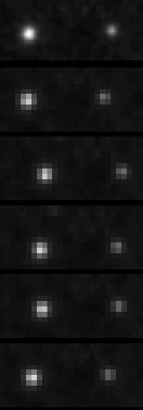

Drizzle este o tehnica de recuperare a rezolutiei pierdute datorita folosirii unui pixel prea mare fata de limita difractiei/seeingului/trackingului (subsampling/undersampling). Este un fel de analiza prin compararea si insumarea subpixelilor din mai multe cadre care au un decalaj spatial (acelasi punct de pe cer trebuie sa nu cada exact pe aceeasi pixeli - dithering). http://www.stsci.edu/hst/HST_overview/docu.../ch32.html
Un alt articol: http://www.stark-labs.com/craig/resources/...le_API.pdf
Totusi, atentie, metoda nu este minunea minunilor:
Why don’t we all use Drizzle all the time?
3. Undersampling: Are your images actually undersampled?
In many cases, especially if you’re shooting wider-field shots, they are.
But, if you’re shooting your 8” SCT at 1 arcsecond per pixel to grab that planetary nebula, you’re images aren’t suffering from undersampled stars. Drizzle can’t help you pull out detail that’s lost from tracking errors or seeing-induced blur.
