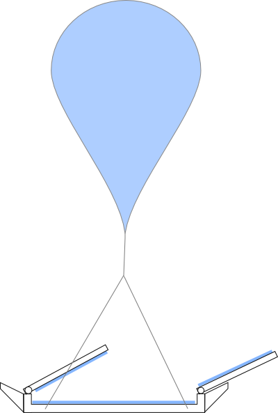

A possible solution to catch "micrometeoriti" could be a structure similar to this, made with polystyrene.
The problem to solve is how to open and close the aerogel compartment and how to be sure it will not interfere with cables and wind.
